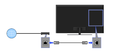

A typical setup will look like below:
How to establish a wired LAN network
  1. Set up your LAN router, following the instructions from the router provider
  2. . On the TV remote, press HOME > Settings > Network > Network Setup. The start-up screen appears
  3. Select Wired Setup > Auto or Custom
    • Auto:Allows automatic configuration of your wired network
    • Custom:Allows manual configuration of the IP address and proxy server
  4. Follow the on-screen instructions
